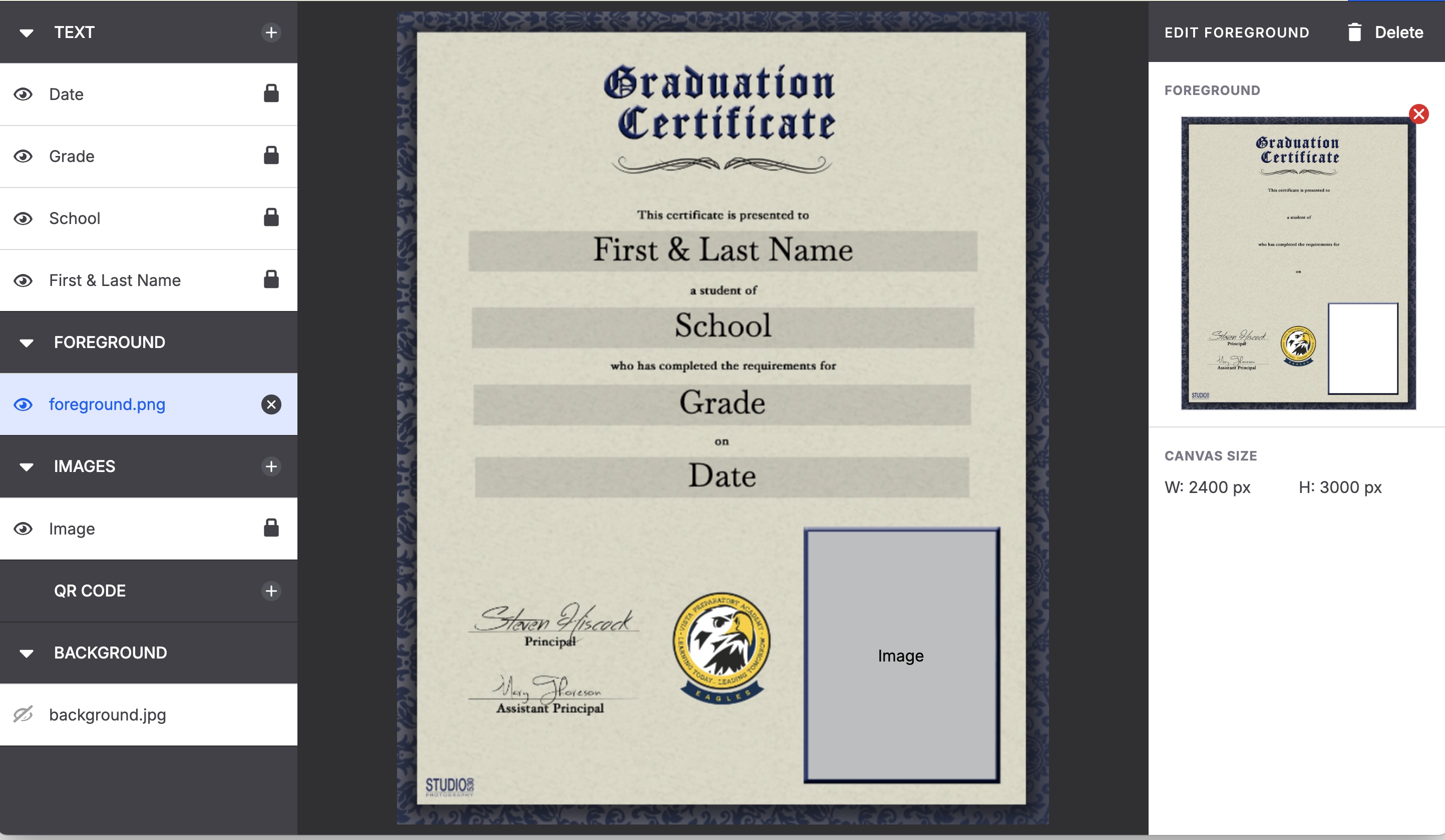

• What you are going to do is create the artwork portion of your certificate in Canva (or Photoshop or any other design application you want to use).
• For the next step, I think that you actually mean to say "My Designs" in Workflow, where you will create a product to whatever specifications you need (8x10, 5x7, etc) for your certificate and you will utilize the artwork created in the first step as either your background, or as foreground (must be a PNG) if you need to layer a background behind an extracted photo. You can then place and populate the fields of the certificate from data already in Workflow (Name, School, Year etc.) and place in the image as well.
• Set this My Design product up as a print template in your job, and do the grouping and sorting as needed when printing the batch if you are fulfilling in house. Or set it up as a non-visable product in your price list if you need to place a batch order from your lab for printing.
Here's a sample of one of our certificates as it looks in My Design.
